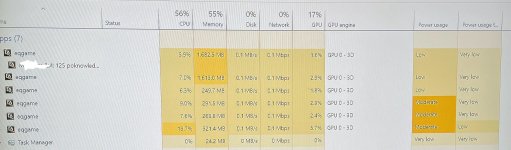

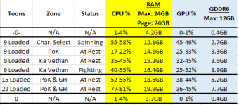

I'd take a look at Task Manager to see your resources when your boxes are loaded. If resources are maxed out, it may cause your system to become unstable. Maybe it's crashing your network? Do you have other applications open that are taking up valuable memory and CPU cycles?
Each time I have been trying to run EQ after having issues from last patch, I have been rebooting my PC to help ensure it is as clean as possible.
For the most part I don't have much bloat in memory. There is apx 500MB total RAM usage that is not EQ when I run it taking up apx 1% CPU.
GPU & CPU are mostly as quite as a church mouse, whisper quite. Once in a while they get louder, but it does not last but a few mins at most.
Yes, some zones cause more draw and can get my case about as loud as casual conversation among 20 people in a room up to excited conversation among 50 people in a room.
"TaskManager-UnderLoad-9PCs.JPG"
"ResourceMonitor-UnderLoad-9PCs.JPG"

6 boxes up in just POK
Graphics turned down and tweaked and I have a
I57500 16 gigs ram and a GTX 780 3 gig Gpu

New GPU Installed Update:
Installed my new 4070 GPU after using my DataVac to clean everything up real well.
I have run some tests with various things and come up with some numbers:
All these tests below were with Luclin Models ON and Stick Figures OFF.
Thus far only MipMapping was turned to FALSE in my eqclient.ini. No other changes have been made.
A few awesome things that have happened after using the new GPU:
  • I have No more jitter on Non-Focused screen associated with the DirectX 11.1 update.
  • Running with all models on and No Stick Figures anymore.
  • GPU Temp never exceeded 40℃. The fans don't even engage until it reaches 50℃. No fan action even with 22 accounts up and running.
An issue I ran into trying to get all 22 accounts I have up and running at the same time. My computer overall was slower and slower to load the accounts. For the last 12 accounts, each group of 6 had 1 toon that would not load into game from character select it would bounce back to server select saying there was no response from the server. So I would hit <End> when it would get to character select again and enter world on the 2ndary toon on that account as trying the one that was bouncing would just cause it to bounce back to server select again.
