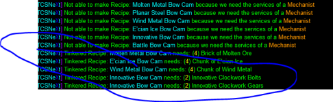

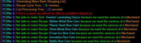

Long overdue for recipes that require other services (not tools) (WIP):
If you are doing fletching and you ain't a gnome you can't make the cams..
This makes sense when you get the innovative clock nuts or whatever and it can't make nothing.. even when you have it all

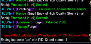

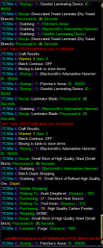

If using the "Artisan Quest" tab to make the "Druzzel's Composite Treant Laminated Compound Bow", it goes into an endless loop.
my bad, I thought a taxidermy kit was something you put stuff in, not used as a ts item. will fix!
Do you have a laminator blade, 2 laminator rollers, and a geerlok laminating device?
I have the geerlok laminating device and the 2 laminator rollers.
Have not been able to make the laminator blade. Even though I have all the materials on-hand.
So you do have this: Small Brick of High Quality Steel, right? It could be a conversion thing..
It wouldn't let me make it automatically with having plenty of these mats in my inventory. It would grab the smithing trophy from the bank and then put it right back. So I made 20 of them manually and still unable to make the laminator blade using TCN.
Once I manually made the laminator blades, the TCN tool was able to do all the other sub-combines and make the "Druzzil's Composite Treant Laminated Compound Bow". So, looks like it just doesn't recognize having the materials for the Laminator Blade.
