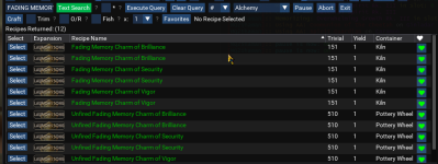

Trying to make a Fading Memory Charm of Security, I get the error below. When I do a search for the item, it returns 2 rows of results for each charm (not sure if that is part of the problem or not)
Please forgive me if this has been asked before, and let me know if there is another way to accomplish this that I have overlooked.

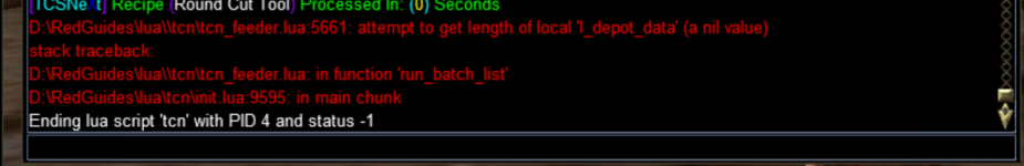

wanted to have it make me all of my cut tools so i didnt have to go to stratos, and it crashed on me
Yeah I will have to check it out, for me, I just go to Stratos and get the tools once, and then they are used for eternity..
My quick look, looks like it has no provision to handle null, but I am suspecting fixing that will not be the panacea, but it's a start.
