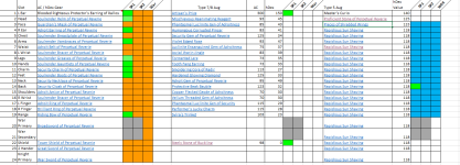

Taking a stab at what hytiek has been doing in the past. This is by no means definitive or right. I put this together off basic sorting from raidloot.com I want to know where i'm wrong and what i need to do to fix. Obv I have this filled out for my tanks and I have not logged my warrior in so his stuff could be way off. Thanks in advance for any input you can help me out with to make this more "correct"!

threw two other tabs on there with DPS page and healer page. DPS page is same as tank for me because I'm using hdex on them. Not sure what the cap is to start using something else. This will never be a BIS at least sourced from me because I do not raid. I think I have it set to where you can copy it and change it to what you like. Please keep telling me where I am mistaken though so I can try to have the best information possible in it.
