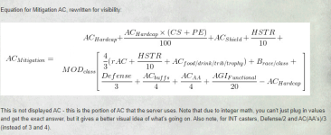

If I could find the ORIGINAL poster I'd give Kudos to them, but it's been compiled/recompiled so many times finding the origin has eluded me.
View attachment 51714 To go with the conv in discord about EQ doesnt math well. Link above will take you to the written out way.

Step12 = If Silk: DefenseSkill / 2
Step12 = Otherwise: DefenseSkill / 3
Step13 = If Silk: (SPA3Buffs + SPA416Buffs) / 3
Step13 = Otherwise: (SPA3Buffs + SPA416Buffs) / 4
Step14 = If brd,clr,mnk,rng: AOWTotal / 4
Step14 = If pal,shd: AOWTotal / 4
Step14 = If bst,ber,rog,shm: AOWTotal / 4
Step14 = If war: AOWTotal / 4
Step14 = If dru,enc,mag,nec,wiz: AOWTotal / 3
Step15 = If Silk: HerosFortTotal / 3
Step15 = Otherwise: HerosFortTotal / 4
Step16 = Step11 + Step12 + Step13 + Step14 + Step15
Now the next step is to calculate an agility bonus if your agility is over 70. This bonus is equal to your 'Functional Agility' / 20. Afterwards if your ac is less than 0, set it back to 0 again. In equation form:
Step17 = If FunctionalAgility > 70: = (FunctionalAgility / 20)
Step 18 = Step16 + Step17
If Step18 < 0: = 0
That was the last thing that the player facing calculation does, so you can return the step18 value to the 'Displayed AC Value' function and you should get the same number you see in your inventory window if all of the math was done right. However the next step that occurs is the most important difference between what you see in your inventory window and what goes into the combat calculations in game, this is where the 'soft cap' on AC is calculated.
The 'AC Soft Cap' is defined in a table for each class at each level. Each combination of those two data points has a 'Soft Cap' and a 'Post Cap Multiplier'. I'm only going to list the values for classes at level 100.
Enchanters, Magicians, Necromancers, Wizards: Cap 408 - Multiplier 0.25
Druids: Cap 418 - Multiplier 0.265
Beastlords, Berserkers, Rogues, Shaman: Cap 432 - Multiplier 0.28
Bards, Clerics, Monks: Cap 448 - Multiplier 0.3
Rangers: Cap 468 - Multiplier 0.315
Paladins, Shadowknights: Cap 488 - Multiplier 0.33
Warriors: Cap 510 - Multiplier 0.35
Based on your class you would take the Cap value then multiply it by the total amount of SPA 259 that you have, divide by 100 then add that back to the cap value. SPA 259 is primarily obtained through Combat Stability but there is a small additional amount granted via Physical Enhancement. For reference, rank 53 of Combat Stability is 80 points and Physical Enhancement is 2 points. In equation form:
Step19 (Server) = (ACCap * SPA259Total) / 100
Step20 (Server) = ACCap + Step19
Now we go back to the amount of 'Shield AC' that was calculated earlier in the function and add that to this newly calculated AC cap. This is what has lead to the traditional wisdom that AC on your shield is anywhere from 4 to 3 times as useful as AC anywhere else.
Step21 (Server) = Step3 + Step20
Now if your total AC is greater than the AC cap we just calculated (a likely scenario at anything but very low levels) we multiply the amount over the soft cap by your class' multiplier and add that to your calculated soft cap value to get your 'Real AC'.
If Step18 > Step21:
Step22 (Server) = Step18 - Step21
Step23 (Server) = Step21 + (Step22 * ClassMultiplier)
Step24 (Server) = Truncate(Step23)
'Mitigation AC' = Step24 (Server)
Otherwise:
'Mitigation AC' = Step18 (Server)
