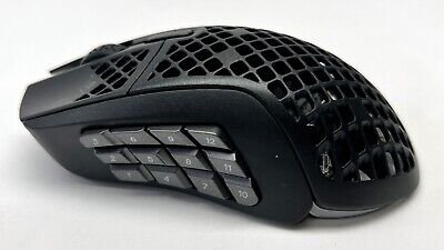

2 - a mouse with more hotkeys.... you are using hotkeys to multibinds and hotbuttons right? Like 20-40?
3 - 32gb of ram, yes 16 works but just do it
This is a good one, normally 150$, 35$ for a refurb one and 9$+9$ for the usb dongle from steelseries, i just bought one and prefer it to my old razer
