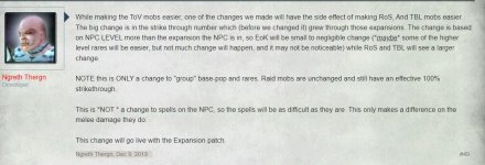

This is the way. IIRC the math comes down to raid mobs having 100% strikethrough (nixing hAgi), so you need that extra hp to cushion rather than the hDex to crit taps and stuff
edit: sorry, the strikethrough nixes any defensives like riposte or dodge, not hAgi. hAgi is ok, just gets parsed out as minimal gains outside of shield slot I think
