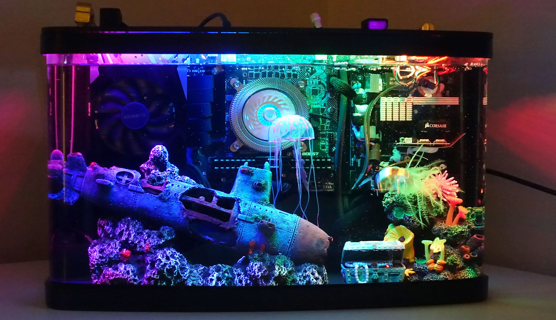

Ok so I added more ram to 32gb, and I changed the case because that original case blocked some USB ports on the mobo.
PCPartPicker Part List
CPU: AMD Ryzen 5 3600 3.6 GHz 6-Core Processor ($199.99 @ B&H)
Thermal Compound: Arctic Silver 5 High-Density Polysynthetic Silver 3.5 g Thermal Paste ($6.60 @ Amazon)
Motherboard: Asus TUF GAMING B550-PLUS (WI-FI) ATX AM4 Motherboard ($178.06 @ Amazon)
Memory: Corsair Vengeance RGB Pro 32 GB (2 x 16 GB) DDR4-3200 CL16 Memory ($162.99 @ Corsair)
Storage: Kingston A400 240 GB 2.5" Solid State Drive ($27.99 @ Amazon)
Storage: Samsung 970 Evo 1 TB M.2-2280 NVME Solid State Drive ($139.99 @ Amazon)
Video Card: Gigabyte GeForce GTX 1660 SUPER 6 GB GAMING OC Video Card ($649.98 @ Amazon)
Case: Anidees AI Crystal Cube ATX Mid Tower Case ($179.90 @ Amazon)
Power Supply: Corsair RM (2019) 750 W 80+ Gold Certified Fully Modular ATX Power Supply ($129.99 @ Newegg)
Operating System: Microsoft Windows 10 Home OEM 64-bit ($108.78 @ Other World Computing)
Total: $1784.27
Prices include shipping, taxes, and discounts when available
Generated by PCPartPicker 2021-01-14 21:42 EST-0500

And btw..that case and many more these days...can be interesting to work with. If you plan to use an optical drive ever...it's gotta be external or a lotta mods need to happen.

Thanks for that. I’ll probably drop the 2.5 ssd. I already have an external optical just in case luckily. I think my new build came out to about $1400ish. I’ll be going piece by piece until I have it all. Unless tax refund season is nice and I can convince my wife lol

I miss read the website. The case I picked had front USB ports but the mobo didn’t have a header to hook them up. Either way, I prefer the new cube case I picked. Compact enough to fit in my desk and off the dustier floor. And large enough to accommodate 13” gpu if need be.
