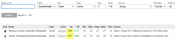

You still need lv120 to max the stat of T1 Waxing armor....and Waxing AC better over lv118 while HP still less..... so I wear Velium Threaded until 120 then change to Luclinite with some Wanning....
However, if you can't get full Velium Threaded armor, the Waxing is still an easy way to upgrade :)
